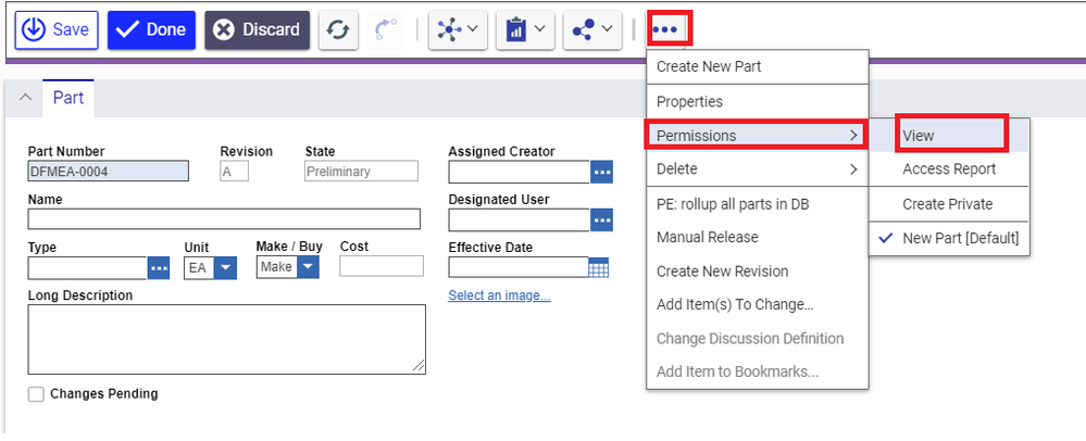

        Yes, you cannot able to lock the In Change item but AML query what I provided should work. Can you check the permission of the inchange part in UI ?
        Check which identity has update access and add your account / admin into that identity
