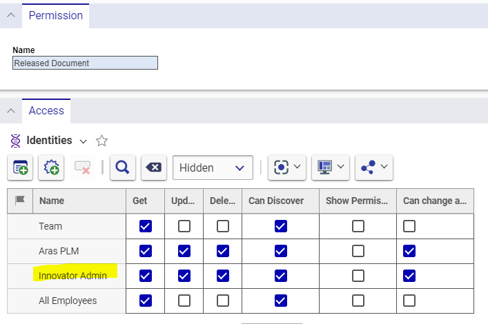

I have checked the permission for In Change Document item type in ARAS instance and only members of ARAS PLM role has access to edit it.
Step 1: Navigate to Administration --> Permissions --> Search and open Released Document permission
Step 2: Lock and add Innovator Admin user under Access tab
Step 3: Save and Unlock Permission
Step 4: Relogin to AML studio or Nash as admin and run the query
<AML>
<Item action='lock' type='Document' id='68FDC33766674A2F9E1A34CBC77F3516' version='0'>
</Item>
<Item action='update' type='Document' id='68FDC33766674A2F9E1A34CBC77F3516' version='0'>
<name>Updating via AML Studio</name>
</Item>
<Item action='unlock' type='Document' id='68FDC33766674A2F9E1A34CBC77F3516' version='0'>
</Item>
</AML>Thanks
Gobikrishnan R
