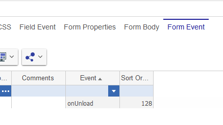

- cogres7 years agoCreator III
Hi Jonatas,
Thanks for the clarifying video! I think what you could do is the following:
You could set an onUnload JavaScript method on the form that you open in the video under "Form Events":
In that JavaScript method you need to include the following line of code:
aras.getMainWindow().work.searchContainer.runSearch();This should make it so that when you close the form shown in the video, it should run the search for "My InBasket" automatically.
Note that if your client side method contains only that line of code, it will run a search on the main window whenever you close that form, even if that does not include the "My InBasket" grid. You'd have to implement some checks in the code beforehand for that.
Hope this helps,C
