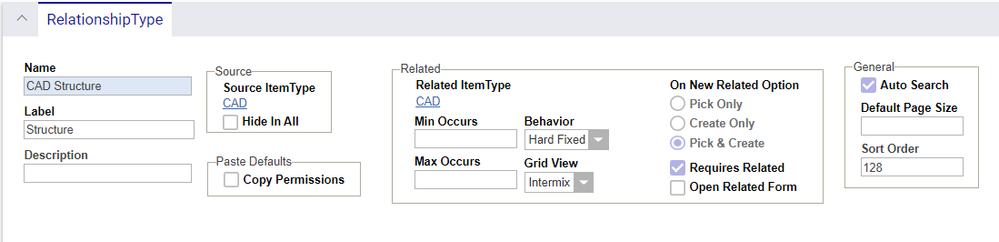

Good day.  Currently we do not have a working CAD connector due to our network infrastructure.  I want to bring all of the CAD files into Aras so they are all in a single location and create a relational data structure.  I noticed that the CAD files added to the CAD Structure act like they are Fixed, but the related_id of CAD Structure is set to float.  How can I change this?  I am not seeing anything that is causing this.  Thank you for your help.
  • Hi Nathan
    I was not sure what behavior you want to set for CAD files and CAD Structure but you can set the behavior in two places. One in CAD Structure relationship and another one on the CAD Properties
    CAD Structure Relationship (Currently it is Hard Fixed)
    CAD Item Type Native Files Property (Currently it is Float)
    Thank You

      Gopikrishnan,
      Good day.  Unfortunately I am still on v11 and don't have the option for the overall Hard-Fixed.  The related_id is set for float, but it acts like it is fixed.
