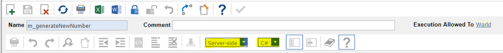

      Ok, I tried adding this method (cavi_part_SaveAs).  When I did a check syntax, it complained about "Missing ";" before statementon line  1" and on lines 2,3,6,7 and 11.
      Is there a formatting issue or something I need to add first?  Note, I'm using Aras V11 SP15.
      When I try to use the method as is I get the error:
      -<SOAP-ENV:Envelope>
      -<SOAP-ENV:Body>
      -<SOAP-ENV:Fault>
       <faultcode>SOAP-ENV:Server</faultcode>
       <faultstring>The method type (JavaScript) specified for cavi_part_SaveAs is not currently supported.</faultstring>
      -<detail>
       <af:legacy_detail>The method type (JavaScript) specified for cavi_part_SaveAs is not currently supported.</af:legacy_detail>
       </detail>
       </SOAP-ENV:Fault>
       </SOAP-ENV:Body>
       </SOAP-ENV:Envelope>
      Thanks for the help.
