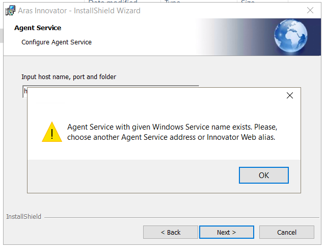

I'm trying to overcome this error:
I had tried to install v12 and while it seemed to complete my db logins weren't working, so I did an uninstall, I cleared out the db and the users. I restarted the VM.
Now, installing, I put the same name for the Agent Agent that I had on the erroneous installation (where I did get a error popup, but it went away and continued configuring the db - MSSQL Express, localhost). But, it doesn't like that. Seems the service name isn't cleaned out on uninstall.

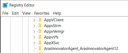

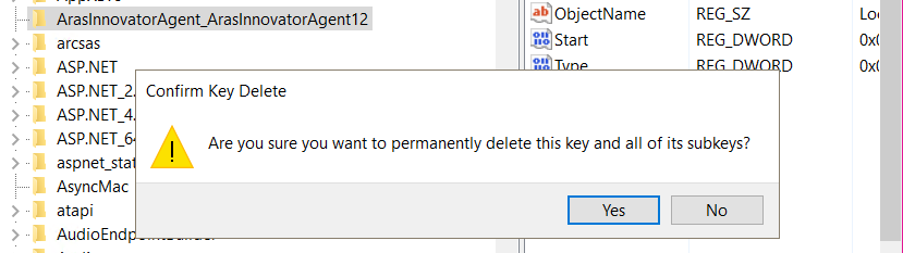

I just found this... let's see! HKEY_LOCAL_MACHINE\SYSTEM\CurrentControlSet\Services\ArasInnovatorAgent_ArasInnovatorAgent12
Seems scary, but it worked for me! I deleted the associated key, restarted the server, and can now install.I believe the uninstaller should remove this, but this works for me right now.
