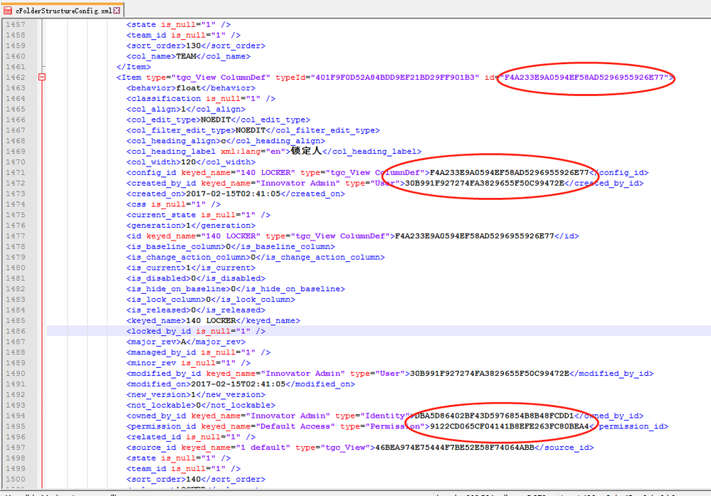

Hi Team,
I am trying to add a " locked_by id "column (who locked the folder) on the collab-folder page, what i did is coping a piece of code of other columns in cFolderStructureConfig.xml, however not sure what these "id" values should be set here and how to get those "id" values
I maked on the screenshout below. Thank you for your help. -jen
8 Replies
  • Hi Jenli,
    I am not super familiar with the collab folder project. Is all the configuration just done in the xml, or was there some configuration itemtype also?
    If it´s really just about the ids and if everything is specified in this xml:
    I would create a fake id for your custom 'tgc_view ColumnDef' and resue this one everywhere where an 'tgc_view ColumnDef' is used (e.g. config_id, keyed_name, etc..).
    All user and permission ids should be fine as long as you want to stick to the original setting.

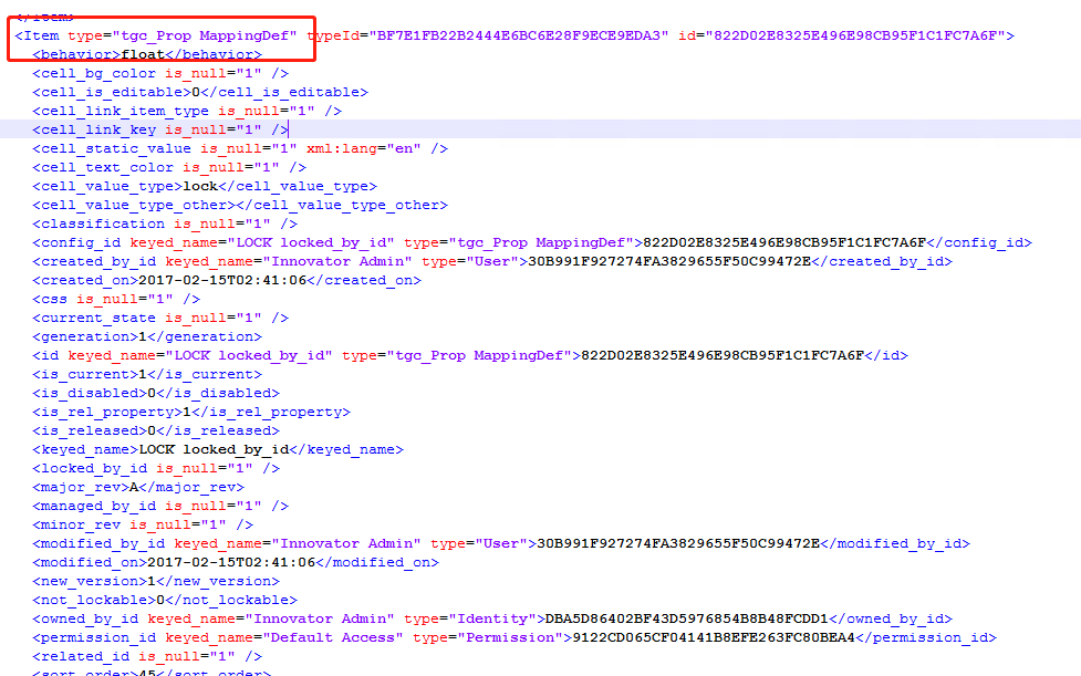

    Do you know, where the link between locked_by_id and your custom column is made?
    • Jenli's avatar
      Jenli
      Hi Angelalp,
      As you suggested that I created a fake id and changed related ID as the same one.
      Also, I found out the link between locked_by_id and column, and made some changes on it as needed, finally it is working now! Thank you! -Jen
      Here is the link code below,
