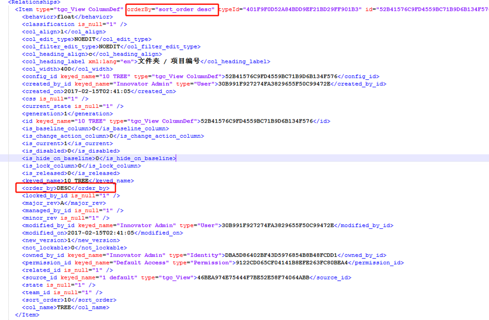

Hi Angelalp,
I may have one more question here, I am trying to set Ascending or descending order of a column as default , made some changes in this xml file still not working. Any thoughs on this? Thanks.
-jen
5 years agoCatalyst II
Have you tried using an orderBy attribute in one of the Item tags?
e.g.:<Item type=myitem" orderBy="sort_order desc" ....>
Also I am not sure if things are so easy to solve with collab foders. Doesn´t it normally render the data as multi level structure?
- Jenli5 years agoCreator I
Angelalp, I just added these two lines in .xml and it seems which is not affected on it. Hmmmm...
