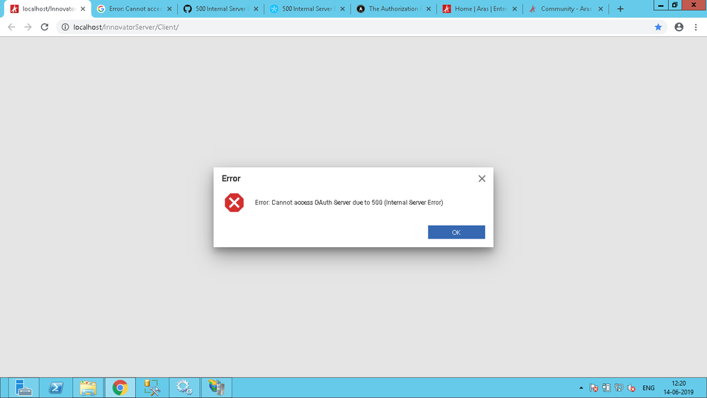

Aras 12: Error: Cannot access OAuth Server due to 500 (Internal Server Error)
We are getting an error as "Error: Cannot access OAuth Server due to 500 (Internal Server Error)" while accessing Aras12. Please help me how to resolve this error.I'm attaching screenshot for your reference.

    I see you posted on the other thread about this same issue, but I wanted to leave a comment here for people who find this in the future. Aras Innovator 12.0 has new requirements from Aras Innovator 11.0. Please check Section 2.1.2 of the 12.0 Installation Guide and ensure you have all of the pre-requisite applications installed.
    This particular issue seems to be most commonly associated with missing the ASP.NET Core/.NET Core Runtime and Hosting Bundle version 2.1.8.

        I just saw this issue on another machine that also already had the runtime and hosting bundle. The issue with that machine was that it was brand new and a recent Windows update that had .NET 4.8 installed but not .NET 4.7.2. I was able to resolve this issue by installing the .NET 4.7.2 developer pack.
        Could you check if .NET 4.7.2 is installed on the server you're having trouble with? One thing to note is that if .NET 4.8 is already installed, you won't be able to use the Runtime installer from the link above since it will complain that a newer version is already installed. That's why I had to use the developer pack instead.
