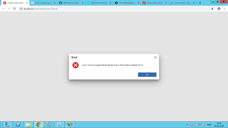

I see you posted on the other thread about this same issue, but I wanted to leave a comment here for people who find this in the future. Aras Innovator 12.0 has new requirements from Aras Innovator 11.0. Please check Section 2.1.2 of the 12.0 Installation Guide and ensure you have all of the pre-requisite applications installed.
This particular issue seems to be most commonly associated with missing the ASP.NET Core/.NET Core Runtime and Hosting Bundle version 2.1.8.
