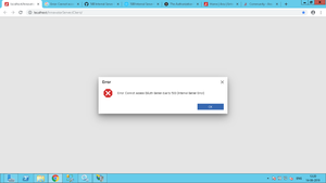

Hello Chris,
I have the same issue. I have new machine with Windows 10 Pro version 1909, which has .Net Framework 4.8 Advanced Services. And hence I am ending up in getting error 500.
As you have correctly pointed out .Net 4.7.2 runtime cant be installed as I already have 4.8. I have installed developers pack for .Net 4.7.2. Do I need to change any configuration file entry so that ARAS application points to .Net 4.7.2?I am still getting the same error 500.
Any help wold be highly appreciated.Thanks,
Jayraj

Although this is weird, the issue was resolved once I installed Hosting Bundle with version 2.1.11 instead of 2.1.8
Here is useful info might save some time for somebody
OS: Windows 10 Pro Version 1909
Windows Feature .Net Framework: 4.8 with Advances ServicesThe issue was resolved once I installed hosting bundle version 2.1.11 instead of 2.1.8
Although it is contradicting ARAS documentation regarding hosting bundle version but it worked for me.
Thanks,Jayraj
