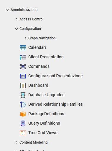

In version 17, the TOC isn't displaying the items in the order I arrange them in the TOC editor. For example, TOC editor displays: But the actual TOC displays Is there some sort of other setting I should be changing? Should I just rearrange them in the wrong order in the TOC Editor and see if they line up eventually like a slot machine?Solved170Views0likes2CommentsWhy do TOC Editor created menu items not show up in in the TOC after packaging and Import

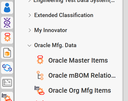

Hi community, in Innovator 12 Aras introduced the wonderful feature to pin often used TOC entries to the TOC sidebar. This saves a lot of time and works in general very well. But there is one exemption: When our ItemType doesn´t use a regular grid, but just shows a TOC View like a custom Form or HTML page. Typically inside Aras this kind of view is used for Dashboards. These kind of ItemTypes can unfortunately not be pinned. I haven´t tested this one in newer Aras version like 14+. Does any one know a workaround? If this one was fixed in any Aras version, I would be happy to know! Angela1.3KViews1like3CommentsWhere and how does the new TOC Editor in Release 2023 store it´s data?

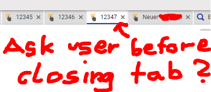

Hi community, I right now work on a MES scenario were I use a TOC View as interface for end users. For some specific use cases (parallel work) I allow that user use multiple instances of the same TOC View in parallel. As user may work with a couple of these tabs at the same time, I want to prevent that they accidentally close any of the tabs. They of course can open the TOC View again and continue were they stopped. But it would add a some comfort if a warning message appears where users can decide if they really want to close the tab. I tried to use an "onBeforeUnload" Method on my Form that returns "true" or "false". The "false" is some kind of accepted by Innovator, as it will then throw me the "Item not saved" error message. But it will still close the tab independent from the user selection. Does anyone know a simple solution to prevent closing a tab? Every idea is welcomed!! :-) Thanks! Angela711Views0likes1Comment
