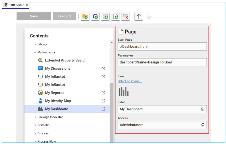

  • Hi Angela,
    Your need may have just been met by the upgraded TOC Editor in V20:
    Kind Regards
    Riaan
      Hi Riaan,
      want to hear a funny story? I unfortunately cannot use V20 cause I don´t have a subscription anymore. My company was affected by the cleanup of subscribers that doesn´t fit the business model (too small..). Smart decision by even more smart people.
      But your tip is still helpful! I guess something similar is already possible in my Innovator 12. I can pass parameters to the TOC view. In my case I use /ShowFormInFrame.html as start page.  But I am not sure which parameter to use to pass an item.  I will give it a try!
