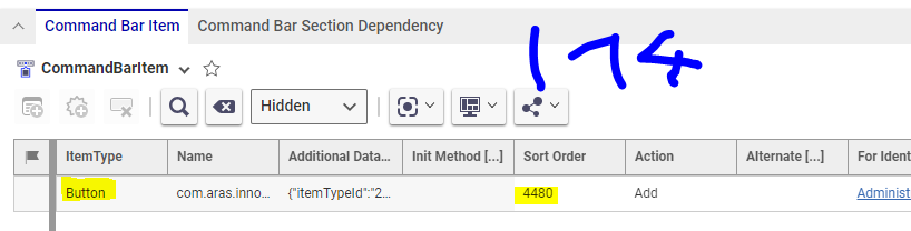

    All the changes were preparations for the TOC Editor in I14.
    Version that support sorting look like this:
    Note the different type for the button (it previously was a Menu Button) and the sort order that is not the standard 128 value.
