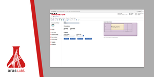

We've released an Aras Community Project that makes it even quicker and easier to take advantage of the Graph Navigation platform feature. The View Card Editor project on the Aras Labs GitHub page provides a user-friendly editing experience with helpful features like a Quick Start Template, Content Editor, and Embedded Graph Preview. Download the project today to try these features in your environment.66Views0likes0Comments
