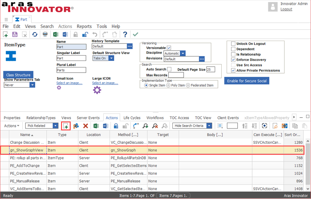

Graph Navigation provides a framework for customizing the content and style of your graph views, but Aras Innovator also includes a default style out of the box to get you up and running quickly. Getting started with Graph Navigation in Aras Innovator is as easy as adding an action to an ItemType. We'll use Part for our example here.
  1. Navigate to Administration > ItemTypes in the TOC.
  2. Search for the Part ItemType and open it for editing.
  3. Select the Actions tab and click the Add New button to pick a related Action.
  4. Search for the gn_ShowGraphView Action and double click to add it to the Part ItemType's actions.
  5. Save and close the Part ItemType.
Now we'll be able to view Parts and their related data using Aras Innovator's default graph settings. In the next section we'll explore the features of the graph viewer.

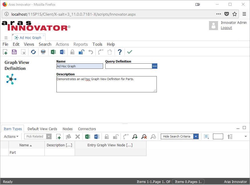

Ad Hoc Graph Views
Ad Hoc Graph Views dynamically query the graph content at runtime. All of the context item's item properties and relationships are automatically included in the graph. The graph viewed in the Getting Started section above is an example of an Ad Hoc Graph View. We can also explicitly define Ad Hoc Graph Views for specific ItemTypes. This allows us to style the view without precisely defining the types of content.
Creating the Graph View
In this example we'll create a new Ad Hoc Graph View.
  1. Login to Aras Innovator as admin.
  2. In the TOC, navigate to Administration > Configuration > Graph Navigation > Graph View Definitions.
  3. Click the Create a New Item icon to create a new Graph View Definition item.
  4. Enter a name and save the Graph View Definition.
Based on this configuration, the resulting Graph View Definition will use the default style and it will be available for any ItemType with the Show Graph action.

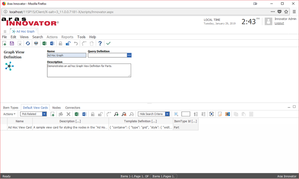

2: Add the View Card to the Graph View Definition
  1. Head back to your Graph View Definition item.
  2. Click the Default View Cards tab.
  3. Click the Add New Relationship icon to pick a related View Card.
  4. In the search dialog, choose the View Card you just created.
  5. In the relationships grid, set the ItemType Id property to the ItemType you want to display using the selected View Card.
You can repeat steps 3-5 for as many View Cards and ItemTypes as you want. Any ItemTypes without an assigned Default View Card relationship will be displayed using Innovator's default style.
Once the Graph View Definition has been saved (and the gn_ShowGraphView action has been added to the specified ItemTypes), we'll be able to select our Ad Hoc Graph View from the Graph View Selector list.

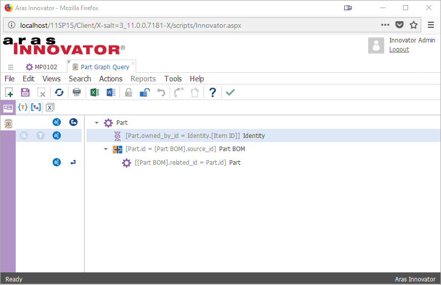

Defining the Query
In this example we'll create a new Query-Based Graph View. The process is similar to creating an Ad Hoc Graph View, but first we'll need a Query Definition. We'll use the Query Definition described in a previous Aras Labs blog post, An Introduction to Query Builder and Tree Grid View.
www.aras.com/.../an-introduction-to-query-builder-and-tree-grid-view
After following the section Creating Your First Query Using QB, you'll have a Query Definition that looks something like this:

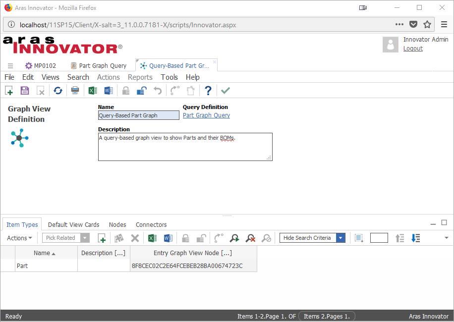

Now you're ready to start creating your Query-Based Graph View.
  4. Enter a name, the Query Definition you want to use, and save the Graph View Definition.

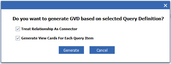

When you save the Graph View Definition, you'll see a dialog like this:
If you select the Treat Relationship As Connector option, all relationships in the Query Definition are treated as connectors. Otherwise, each relationship is drawn as a separate node and connectors will be implicit (like an Ad Hoc Graph View). We'll select this option for this example so we don't see a node/block for each Part BOM relationship.
If you select the Generate View Cards For Each Query Item option, a unique view card is generated for each Query Item and added as a GVD Default View Card. The generated view cards will have a row for each property selected for the Query Item in the Query Definition. We'll select this option so we don't have to worry about mapping the query results to an existing View Card.
Once we select our options and click Generate, we have a Graph View Definition that looks something like this:
Viewing the Graph
Once the Graph View Definition is saved, we can select it from the Graph View Selector just like we did with the Ad Hoc Graph View.
