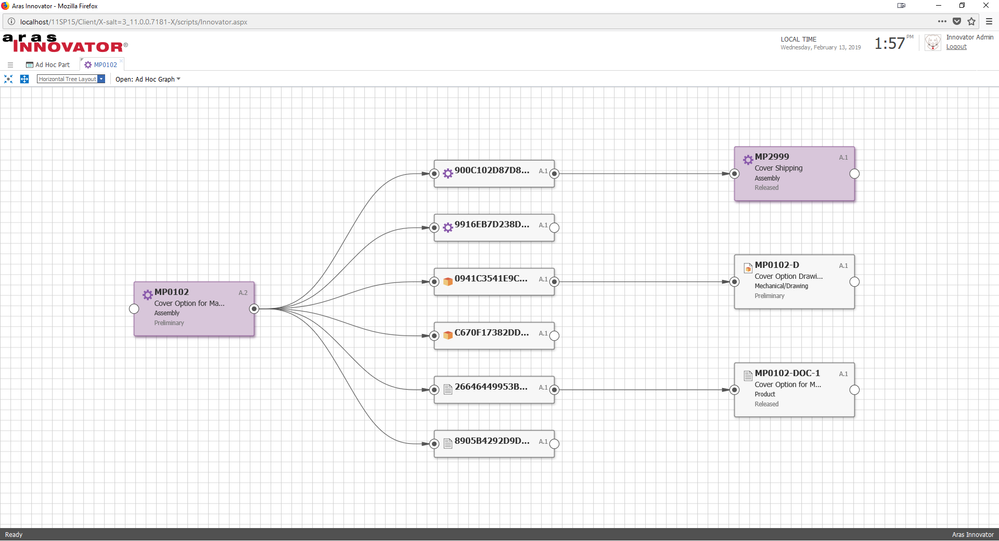

Here's what the Ad Hoc Graph View looks like without any View Cards applied:

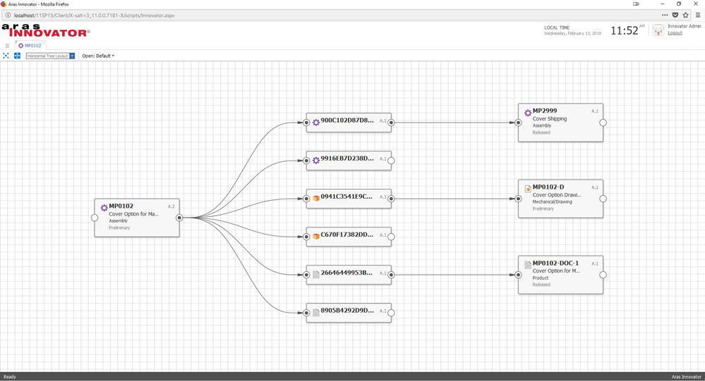

Now we have a good starting point for our custom node, however if we open up our Graph View it will look a lot like the default style provided by Aras Innovator out-of-the-box. We need to make some changes to the template JSON to make the graph look more interesting.

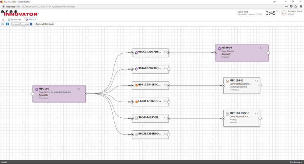

After updating the Template Definition and saving the View Card, our template JSON should look like this and the graph should look something like this:
Now the styled Part nodes stand out in the graph view, but we have a request from users to make the card wider to show more of the item's name. Let's use the template JSON to modify the layout of the node content.
Customizing Node Content

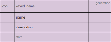

Think of the contents of a graph view node as a simple table. Each View Card describes the table with an array of row objects, an array of column objects, and an array of cell objects. If we drew out the table for our current View Card, we'd get a table of four rows and three columns with the content determined by the container.style.cells array.
If we want to make the name column wider, we just need to increase the width property of the second column object in the container.style.cols array. Let's change it from 120 to 190.
We also need to adjust the overall dimensions of the node to accommodate the increased column width. We can do so by updating the container.style.width property to 290.
Once we've updated the template JSON and saved our View Card, our graph should reflect the wider node dimensions:

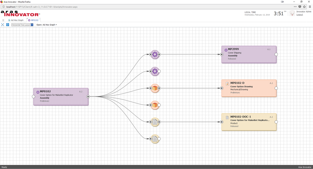

By applying these techniques we can configure graph views in any number of ways. Here's the same graph view with additional View Cards configured for the Document and CAD ItemTypes, as well as their relationships to Part.
