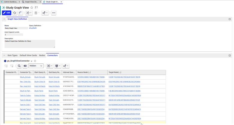

Go to the TOC > Administration > Configuration > Graph View Definition. Open the Graph View Definition you’d like to modify the direction of. Open the Connectors tab. It should look like this
The important part of this is the Source and Target Node columns. Find the relationship you’d like to reverse the direction of by looking at the start/end query item. Once you’ve located the row you’re looking for, you can swap the values for the Source and Target Nodes. This will flip the direction of the connector, allowing for more easily digestible Graph Nav Views.

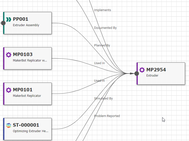

The final step is opening up the Connector Type for the row you just modified. Under the Properties relationship, you can add a new Property called description (case sensitive), and in the value template, add the text you’d like to add to your Connector. When you open your Graph Nav View, you’ll see beautifully labeled Connections.

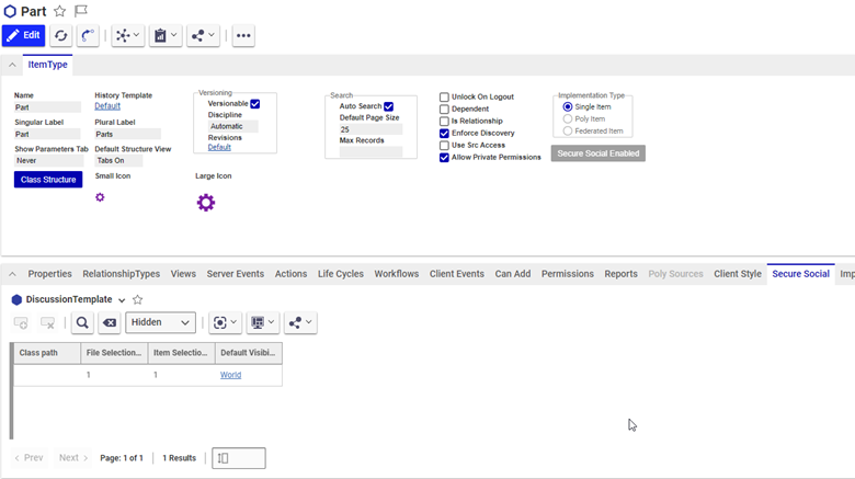

This is a quick one, but it helps ensure people are aware of the discussion surrounding whatever Item they may be viewing at a given moment. Having the pane default to open allows any new discussions to be immediately visible to anyone viewing a given Item. To do this, we’ll take a look at the Part ItemType. Start editing the Part ItemType and open the Secure Social relationship:

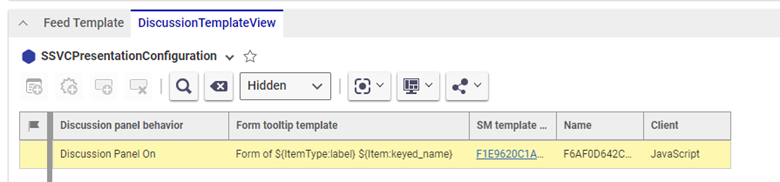

Right click the Discussion Template and open the related item. You’ll see a Discussion Template with two relationships. Open the Discussion Template View tab. Here, you’ll see a single Item with a few properties. The important one is Discussion Panel Behavior. Editing this relationship and setting this to Discussion Panel On will make it so the discussion panel automatically opens when you open an Item. This is set on an ItemType by ItemType basis, so set it wherever you think collaboration could use a boost!
