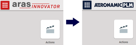

Hello everyone, Here is a short instruction on how to remove the Enterprise Search (ES) bar when logged in into Aras V12. This can be helpful to prevent confusion amongst end-users if you decide not to use the feature. Before: After: This can be achieved by taking these steps: Open the TOC and go to Administration > Configuration > Client Presentation Perform a search and open the single record that you find named 'JavaScript' On the 'JavaScript' item, click on the 'Global' item / URL On the 'Global' item, open the 'Command Bar Section' relationship and expand the 'Name' column Scroll down until you find an item with the name 'com.aras.innovator.mwh_es_toolbar' and open it In the 'Command Bar Item' relationship, find the button 'com.aras.innovator.mwh_es_search_button' and set the action to 'Remove' instead of 'Add' I hope this helps. All the best from Almelo. Daan2.9KViews2likes2CommentsInstruction: Changing the Header Logo in Aras Innovator V12
Hello everyone, Here is a short instruction on how to change the client header logo when logged in into Aras V12. Whereas V11 used a simple .svg file inside the code tree, in V12 we need to dive a little deeper: Open the TOC and go to Administration > Configuration > Client Presentation Perform a search and open the single record that you find named 'JavaScript' On the 'JavaScript' item, click on the 'Global' item / URL On the 'Global' item, open the 'Command Bar Section' relationship and expand the 'Name' column Scroll down until you find an item with the name 'com.aras.innovator.cui_default.mwh_header' and open it On the 'com.aras.innovator.cui_default.mwh_header' item, open the 'Command Bar Section' relationship and expand the 'Name' column Find the item with the name 'com.aras.innovator.cui_default.mwh_header_logo' and open it Click 'Edit' and attach your logo file to the property that has the 'Image' label Note: using .svg files is recommended by Aras because it scales without stretching and your logo will not get blurry or pixelated (.svg is a vector format). I hope this helps. All the best from Almelo. Daan2.9KViews2likes2CommentsHow to export basic CUI configurations
