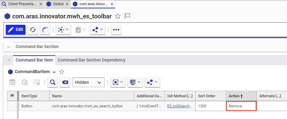

This can be achieved by taking these steps:
  1. Open the TOC and go to Administration > Configuration > Client Presentation
  2. Perform a search and open the single record that you find named 'JavaScript'
  3. On the 'JavaScript' item, click on the 'Global' item / URL
  4. On the 'Global' item, open the 'Command Bar Section' relationship and expand the 'Name' column
  5. Scroll down until you find an item with the name 'com.aras.innovator.mwh_es_toolbar' and open it
  6. In the 'Command Bar Item' relationship, find the button 'com.aras.innovator.mwh_es_search_button' and set the action to 'Remove' instead of 'Add'
I hope this helps. All the best from Almelo.
Daan
