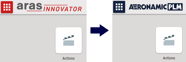

Instruction: Changing the Header Logo in Aras Innovator V12
Hello everyone,
Here is a short instruction on how to change the client header logo when logged in into Aras V12.
Whereas V11 used a simple .svg file inside the code tree, in V12 we need to dive a little deeper:
  1. Open the TOC and go to Administration > Configuration > Client Presentation
  2. Perform a search and open the single record that you find named 'JavaScript'
  3. On the 'JavaScript' item, click on the 'Global' item / URL
  4. On the 'Global' item, open the 'Command Bar Section' relationship and expand the 'Name' column
  5. Scroll down until you find an item with the name 'com.aras.innovator.cui_default.mwh_header' and open it
  6. On the 'com.aras.innovator.cui_default.mwh_header' item, open the 'Command Bar Section' relationship and expand the 'Name' column
  7. Find the item with the name 'com.aras.innovator.cui_default.mwh_header_logo' and open it
  8. Click 'Edit' and attach your logo file to the property that has the 'Image' label
Note: using .svg files is recommended by Aras because it scales without stretching and your logo will not get blurry or pixelated (.svg is a vector format).
I hope this helps. All the best from Almelo.
Daan

      I changed the background color of the navigation button also in the main + the minified CSS files found in the code tree. I have looked into this, but I could not find an option in the database either.
