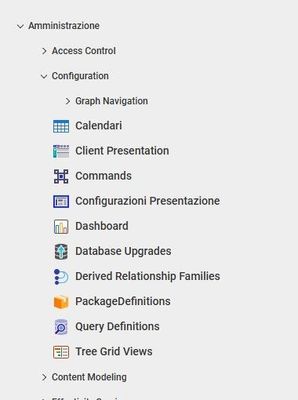

Hello Community, I've just tried to Package a staging table environment that includes TOC Menu elements created in the TOC Editor. The Import did not result in the rendering of the added TOC Menu Items in the TOC Menu or TOC Editor. I would appreciate any help or in site I can get to learn what I have done wrong or left out. The process I went through is described below. Note: I did go through the Docs but the process to even add the [Presentation Configuration] is incorrect and does not tell what to check for in the export. So this conversation will help that. www.aras.com/.../Importing and Exporting.htm --- Process -------------------------------------------------------------------------------------------------------------------------- I created a Package for the configured Items, Forms, Relationships, etc. All of these Exported and Imported correctly. I added the TOC Category (CommandBarMenu) and Itemtype (CommandBarMenuButton) to the Package using the Package Button. Doing this added the following Package Groups to the package: Menu, Menu Button, Command Bar Section Next: 1) I navigated to one of the configured ItemType's, [Client Style] tab 2) Double clicked on on the [Presentation Configuration] in the Grid; "rh_Oracle_Mfg_Item_TOC_Configuration" 3) Clicked [Search Presentation Configurations] 4) Searched for the required [Presentation Configurations], 5) Selected all Required 6) added then to the Package via the right Click [Admin] menu. Doing this added the following Package Group to the package: Presentation Configuration 7) I did the Export and all packaged elements were represented in the manifest and import folders 8) I did the Import into the new staging DB instance. [View:/community/cfs-file/__key/communityserver-discussions-components-files/3/2024_2D00_1_2D00_30.12_2D00_57.log:320:240] 9) In the new Instance I a) Opened the TOC and nothing. I opened the TOC Editor and nothing b) I checked the SQL Server tables to see if all the elements, defined in the XML files, had been loaded. All Elements had been loaded into the tables: - PRESENTATIONCONFIGURATION - COMMANDBARMENU - COMMANDBARBUTTON - COMMANDBARMENUBUTTON c) I checked the Itemtypes to see if the [Presentation Configuration] were set on the [Client Style] TAB. And they were: d) Lastly, tried clearing the IIS cache and the Browser cache No Luck Thanks for the help and/or in site.0Views0likes9CommentsPin-to-Sidebar of TOC Views - There has to be a way, but how?

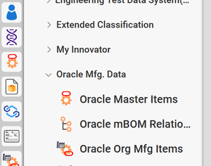

Hi community, in Innovator 12 Aras introduced the wonderful feature to pin often used TOC entries to the TOC sidebar. This saves a lot of time and works in general very well. But there is one exemption: When our ItemType doesn´t use a regular grid, but just shows a TOC View like a custom Form or HTML page. Typically inside Aras this kind of view is used for Dashboards. These kind of ItemTypes can unfortunately not be pinned. I haven´t tested this one in newer Aras version like 14+. Does any one know a workaround? If this one was fixed in any Aras version, I would be happy to know! Angela1.1KViews1like3CommentsWhere and how does the new TOC Editor in Release 2023 store it´s data?

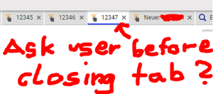

Hi community, I right now work on a MES scenario were I use a TOC View as interface for end users. For some specific use cases (parallel work) I allow that user use multiple instances of the same TOC View in parallel. As user may work with a couple of these tabs at the same time, I want to prevent that they accidentally close any of the tabs. They of course can open the TOC View again and continue were they stopped. But it would add a some comfort if a warning message appears where users can decide if they really want to close the tab. I tried to use an "onBeforeUnload" Method on my Form that returns "true" or "false". The "false" is some kind of accepted by Innovator, as it will then throw me the "Item not saved" error message. But it will still close the tab independent from the user selection. Does anyone know a simple solution to prevent closing a tab? Every idea is welcomed!! :-) Thanks! Angela620Views0likes1Comment
