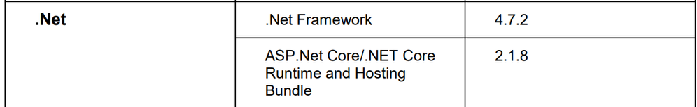

        Can you verify that the version of .NET Core installed on the machine matches the version which is a prerequisite within the installation documentation?
