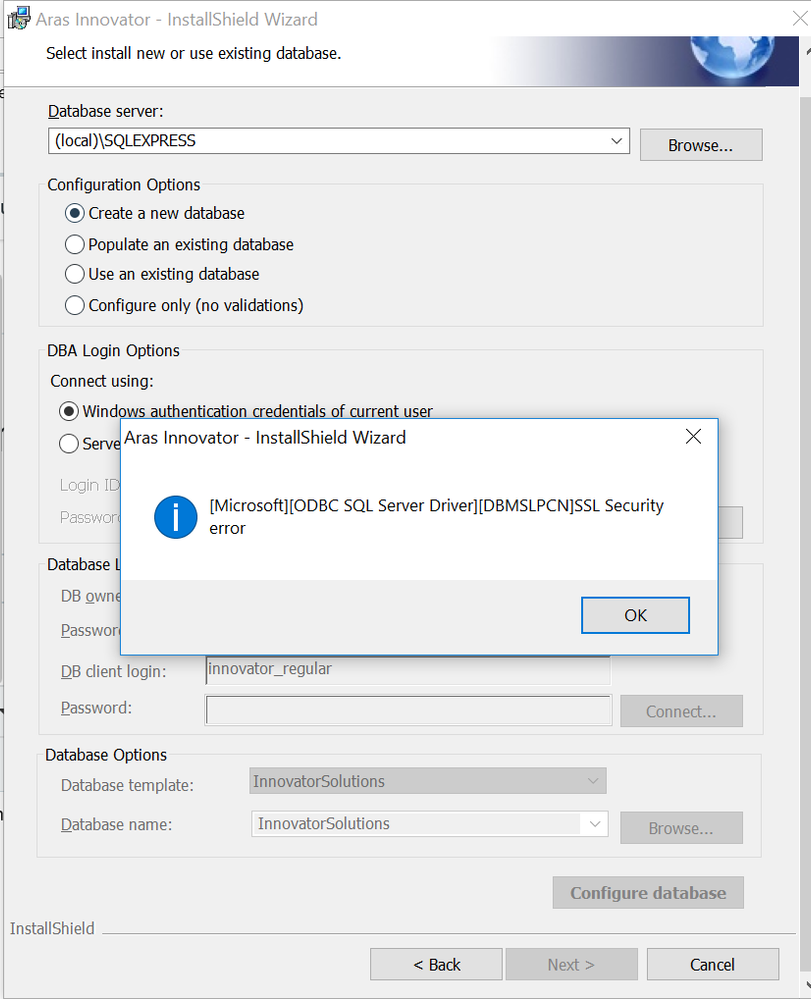

Error : Microsoft [ODBC SQL Server Driver]SSL Security Error
I am getting this error while ARAS installation, DB configuration. If anybody faced the same error or can provide a solution that will be helpful.

    the same problem, how to fix? app server: windows 2019 standard, database server: mssql2017 express on centos 8 x86_64.

      Yes! I've resolved this problem myself.
      In this case, your database server is not selected in the pull down menu.
      →(Local)\SQLEXPRESS is your database server name?
      Server name is similar with server name which is selected when you start SQL server Management Studio.
      BR!

        I used the IP not the server name to connect, it can connected with sqlcmd successful, but not in the installation.
