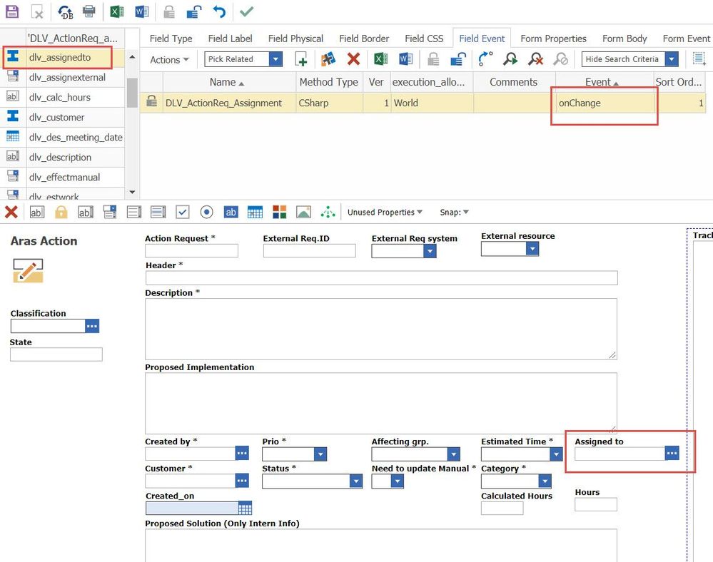

We have a customized task request application in Aras and I want to build a method to send assignee an email when the task has been assigned to the person.
I want to add the method to a field event, onChange. So, when the assignee changes value, an email will be sent. See attached screenshots.
And my code:

    3. Open form where this dlv_assignedto property exist
    4. Add Form field event on dlv_assignedto property (Method Name : ARAS_Community_JS and event : On Change)
    5. Save and Unlock Form
    6. Try testing.

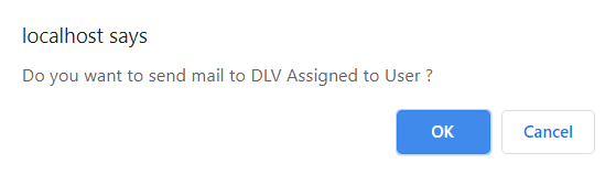

    Expected Result:
    Whenever the dlv_assigned_to field is changed, it will ask for confirmation from user whether to send email to user, if user select Ok, then it will send email else it will not send email

  • This method seems to be a server method so it wont work on field events (field events are JavaScript method). I tried using your method in onAfterUnlock and it works fine for me. Let me know if you are getting any specific error.
    Thank You

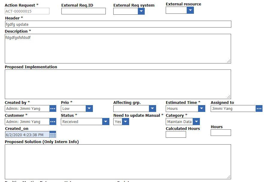

    • yanjim's avatar
      yanjim
      Hi Gopikrishnan,
      Thank you for your kindly reply!
      I did not get any error from Aras GUI, just did not get any email when using onAfterUnlock.
      But from the log file, I found following:

    • yanjim's avatar
      yanjim
      Hi Gopkrishnan,
      Thank you for your kindly reply.
      I did not get any error message, but did not get any email with onAfterUnlock by some reason. Did you make any modification from my code above?
      BR,
      Jimmi

  • Hi Jimmi,
    I'm not sure a field event is the best option for this particular use case. The changes that are made within the form are only suggestions until the user clicks the save button to write those changes to the database. The onChange field event triggers when the actual field is filled in and not when the property is changed at a database level. In a situation where a user accidentally clicks on the wrong user when filling in the field and then corrects their mistake before clicking save, the wrong user will still get a notification that a task was assigned to them even though it isn't.
    For that reason, this use case is likely best handled server-side. If there is a Workflow or Life Cycle attached to this item, you could configure those to send an email without needing to write any extra code. If there's not, this is probably best done in an onBeforeUpdate server event where you can query for the old value of the div_assignedto property to check if it's being changed, and then send the email if it is.
    Christopher Gillis
    Aras Labs Software Engineer
    • yanjim's avatar
      yanjim
      Hi Chris,
      Agree! But I couldn't get the old value of div_assignedto to work, can you help me with that? See my reply 2020-06-12, 5 pm
      /Jimmi
