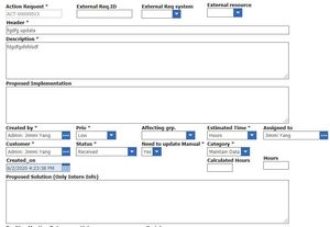

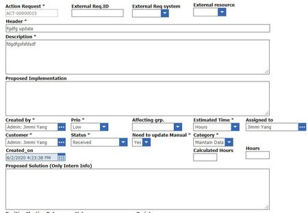

Hi, We have a customized task request application in Aras and I want to build a method to send assignee an email when the task has been assigned to the person. I want to add the method to a field...

    3. Open form where this dlv_assignedto property exist
    4. Add Form field event on dlv_assignedto property (Method Name : ARAS_Community_JS and event : On Change)
    5. Save and Unlock Form
    6. Try testing.
    Expected Result:
    Whenever the dlv_assigned_to field is changed, it will ask for confirmation from user whether to send email to user, if user select Ok, then it will send email else it will not send email
