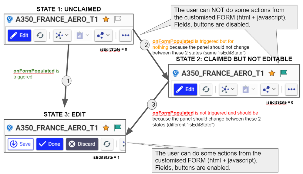

    But I have another issue that I tried to summary in this schema:
    As you can see, I don't have the same state if I go through (1) or (2)+(3).
    I didn't find even triggered when we go from "claimed" to "edit".
    Do you know a solution on ARAS 12 ?
