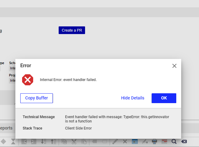

Thanks angela, that command gives the same error. We've opened up a bug report on this one with Aras as we've tried just about every variation of it from the Programmer's guide and nothing seems to be working. OOTB methods don't see to have something exactly the same, but those that have similar commands seem to be referring to the same commands, so stumped on this..

It's very strange. Have tried following combos:
[embed:dc8ab71f-3b98-42d9-b0f6-e21e02a0f8e2:3ec7a2a4-62ac-45d3-956e-711183c94495:type=javascript&text=var%20innovator%20%3D%20new%20Innovator%28%29%3B%0D%0Avar%20pr%20%3D%20innovator.newItem%28%22PR%22%2C%22add%22%29]
[embed:dc8ab71f-3b98-42d9-b0f6-e21e02a0f8e2:8b871be7-5d32-4b22-8a7f-83c186ff00e1:type=javascript&text=var%20pr%20%3D%20new%20Item%28%29%3B%0D%0Avar%20pr%20%3D%20this.newItem%28%22PR%22%2C%22add%22%29%3B]
[embed:dc8ab71f-3b98-42d9-b0f6-e21e02a0f8e2:7beed4b6-ccfa-4bbf-a15b-3f7c80c0d023:type=javascript&text=var%20myInnovator%20%3D%20this.getInnovator%28%29%3B%0D%0Avar%20pr%20%3D%20myInnovator.newItem%28%22PR%22%2C%22add%22%29%3B]
[embed:dc8ab71f-3b98-42d9-b0f6-e21e02a0f8e2:26bb3bd2-2872-4231-b986-5e5fd12e801a:type=javascript&text=var%20pr%20%3D%20this.newItem%28%22PR%22%2C%22add%22%29%3B]
[embed:dc8ab71f-3b98-42d9-b0f6-e21e02a0f8e2:ef794eda-5599-491a-bd2a-5c6ee5bcf6e6:type=javascript&text=var%20pr%20%3D%20aras.newItem%28%22PR%22%2C%22add%22%29%3B]

Good suggestion. Just a form button with the this.getInnovator() version of the code.
