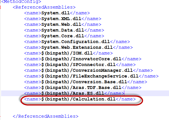

    1. Copy the calculation.dll in server bin folder  e.g.(C:\Program Files (x86)\Aras\Innovator\Innovator\Server\bin).
    Register your dll in method-config.xml file (C:\Program Files (x86)\Aras\Innovator\Innovator\Server)
    1. Open method-config.xml file :
    2. Add your dll the namespace under <ReferencedAssemblies> xml tag

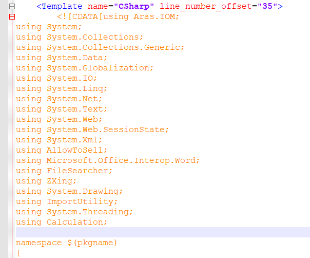

    3. Add your dll reference in <Template name="CSharp">

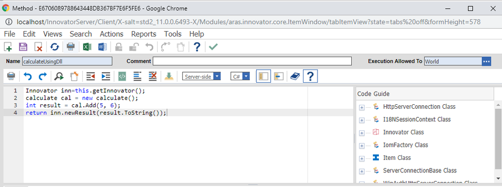

    Create your method in Aras and call your dll method from aras method.

    2. Copy your dll into Server bin folder e.g.(C:\Program Files (x86)\Aras\Innovator\Innovator\Server\bin).
    3. Register your dll in method-config.xml file (C:\Program Files (x86)\Aras\Innovator\Innovator\Server)
    4. Create your own method in aras and in that method create object of dll class and call your method by using newly created object.
