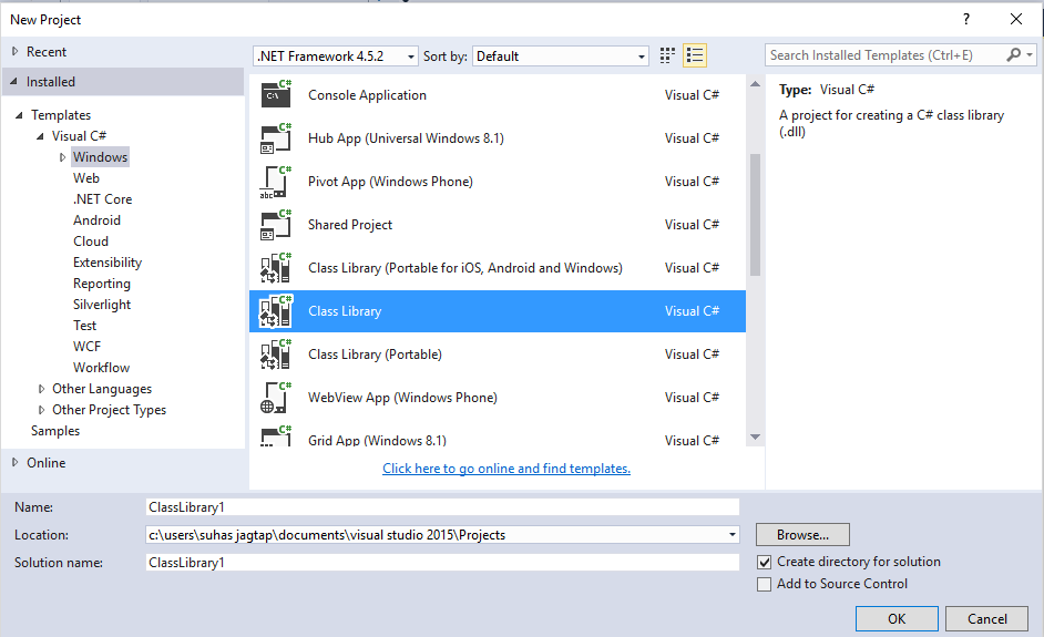

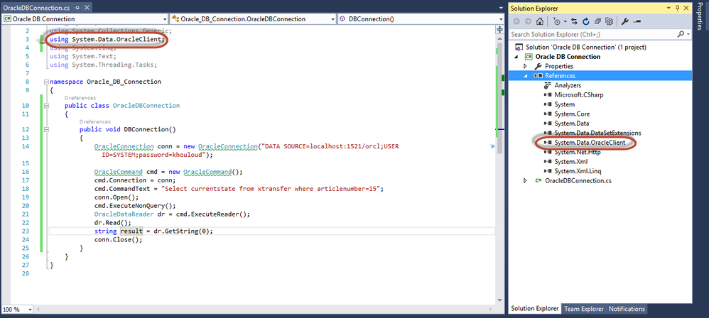

    Below is the link for how to create DLL in VS:
     https://www.c-sharpcorner.com/UploadFile/1e050f/creating-and-using-dll-class-library-in-C-Sharp/
