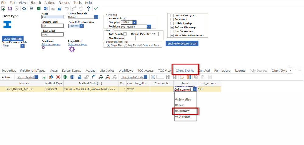

        Hello Nesonar,
        Please find the below screen shot.
        attach here your javascript client method.
        from javascript method open confirmation box:
        var txt;
        if (confirm("Press a button!")) {
        txt = "You pressed OK!";
        } else {
        txt = "You pressed Cancel!";
        based on txt take your action. or call your server side c#/VB method.
        Regards,
        Suhas
