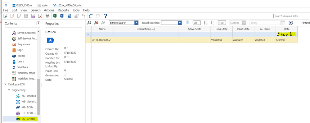

Hello, I would like to set default value on "state" property (example : "Start") to be able get only item where the value of state is equal to "Start" ?
I thought by creating a event on "state" property (event = OnSearchDialog)  could give the result...It seems not (except I made an error)

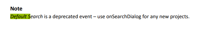

      thanks for your answer but I saw in documention
      so, after testing, it is not work fine !
      it is why I tested with an event (OnSearchDialog) on state property with no effect too :-(
        Oh that´s has to be something new. Default search still works in my Innovator 12.
        Which version do you use for testing? Where do you have seen this note?
