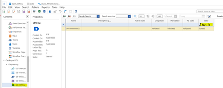

hello, we are migrating to new ARAS version ! :-)
thanks for your answer but I saw in documention
so, after testing, it is not work fine !
it is why I tested with an event (OnSearchDialog) on state property with no effect too :-(- angela4 years agoCatalyst II
