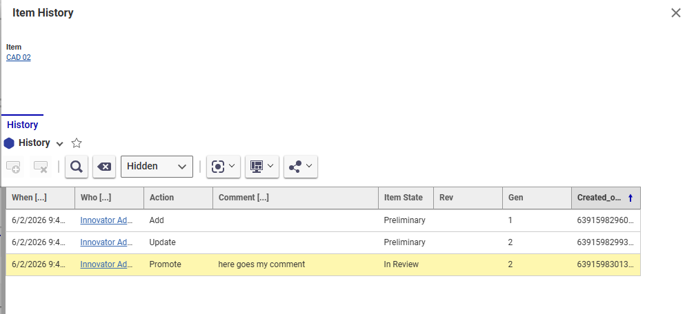

  • I never find a OOTB solution for this one.
    But you can make a get query to the connected "History" items to get the latest comment for the entry with action "Promote".
  • Hello
    Given your Item is versionable True and a new generation is created onPromote, the comment will be visible in the Life Cycle history:
      this is exactly the comment that we want! But - we the community want to use it in Methods and do something with it automatically. The only solution I know so far is a classic "get" query over the history. It works well and is not hard to do, but I wished Aras would have an OOTB solution! Maybe an idea for the roadmap?
      Ciao
      • yes, that's the correct approach.
        On the other side, if all was already OOTB I would have no job 😅
