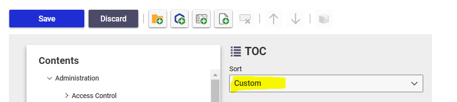

I'm able to export my TOC correctly with Sort = "alphebatical".
But I don't find which object I need to export to have my new TOC with sort = "Custom".
I tought it was included in com.aras.innovator.cui_default.toc.xml....but No !
Which one is it ?

    com.aras.innovator.cui_default.toc is just the replacement of the "Categories" List from I12 and I11.
    There is not special saving location. The "custom" mode is just a trick. By default Innovator sorts alphabetical. If custom is enabled, Innovator sorts by the sort_order used for the CommandBarItem in the corresponding TOC-CommandBarSections. So as soon you export your CUI items, you automatically rebuild the "Custom" sorting.

      But, when I install a new platform (example: OPER), I have to MANUALLY adjust the Custom parameter in the TOC management to have the correct order.
      Is it possible to have the correct sort without manually updating the parameter after deployment?

        To my current (!!!) knowledge, you need to update the sort_order of com.aras.innovator.cui_default.toc AND sort_order of the individual TOC sections of each ItemType.
        So theoretically you only have to merge sort_order of table CommandBarSectionItem, cause this table contains all elements. Maybe just merge the table completely with SQL. You could maybe also use an AML script to update the items to the new target values.
