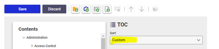

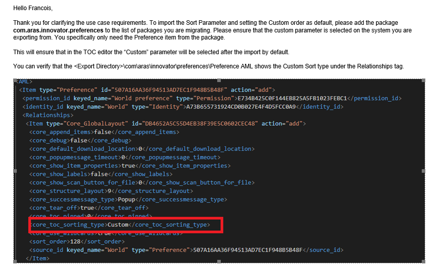

Hello, thank you for your answer. :-)
But, when I install a new platform (example: OPER), I have to MANUALLY adjust the Custom parameter in the TOC management to have the correct order.
Is it possible to have the correct sort without manually updating the parameter after deployment?
THANKS
