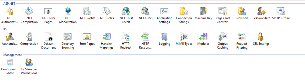

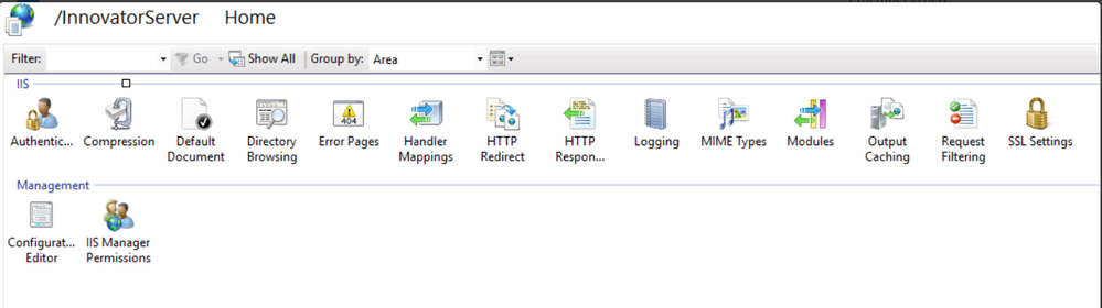

How to configure SMTP Email in IIS for ARAS 14+
There use to be SMTP email option for aras instance where SMTP server details could have been configured, but with ARAS 14+, this option is missing. Is it because of .Net Core change
Am i missing something. On the other instance, SMTP Email is visible. Can someone lend their expertise

      It is on the same server. For other instance like 11 & 12 SP18 i can see SMTP mail but for 14 i cant. Below screen shot for aras 12 instance on same IIS application pool
      Basically entire ASP.Net area is missing for ARAS 14

        But you are probably right. Aras 14+ has replaced ASP.NET with .NET Core components. But I don´t think the SMTP object is gone. It´s just somewhere else.
        Take a look at the Installation Guide regarding emails. Maybe there are some hints.
