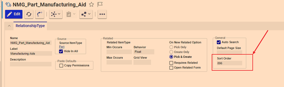

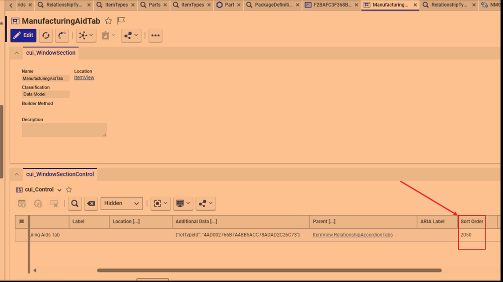

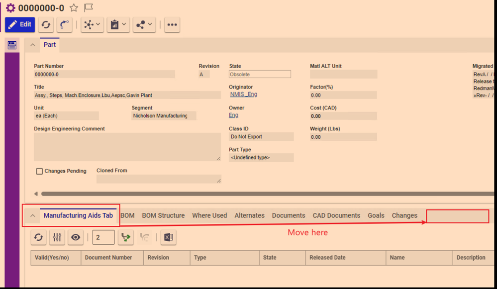

I needed to make a tab visible to certain identity. Therefore, I selected "Hide All" in the relationship types and used the CUI control to make a new tab. I need this tab to be all the way to right.
Sort Order fields don't work, neither in the Relationship Type nor in cui_windowSection. Pictures below

    Make sure your CUI entry's sort order is lower than the one you want the relationship to be Infront of.
    Make sure the same value is used for the relationship inside the datamodel of the ItemType.
    Make sure that the tab order is configured as well.
    If all of these are properly configured, try restarting IIS (just in case) and clear you cache. All of these combined should get you the result you are looking for :)

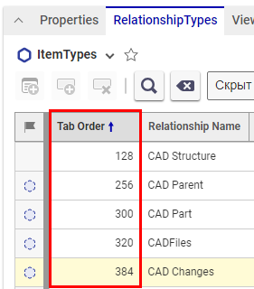

  • You need to change the "Tab Order" property for you relationship on tab RelationshipTypes of parent item type.
