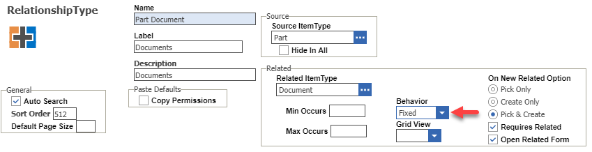

  • Hello,
    This depends on the behavior of the RelationshipType. By default, the behavior of a relationship is set to Float which means that the relationship will always point to the latest generation of the related item. If you would like your relationships to point to previous generations you can set the behavior to Fixed by following the steps below.
    1. Login as admin
    2. Navigate to TOC > Administration > RelationshipTypes
    3. Search for Part Document
    4. Open this item for edit
    5. Change the Behavior dropdown to Fixed
    6. Save this RelationshipType
