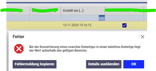

    My previous filter worked more or less for certain dates. I now tried some complete different dates and this time I even got an error message that doesn´t appear before:
    AND (CurrentItem.created_on > '2025-09-15')
    OR
    AND (CurrentItem.created_on > '2025-09-15T05:00:00')
    resulted in:
    -> Converting a nvarchar data type to a datetime data type resulted in a value that is out of range.
    I use Innovator 12, does anyone know if this one is a know behavior and fixed already?
