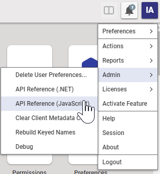

    I would recommend taking a look at the blogs on this site. Aras Labs has multiple blogs on working with forms and grids using JavaScript.
    On top of that, within innovator there is a Javascript API reference which can get you started. It can be found here:
    AJ

    Hi QuyenTH,
    AJ
