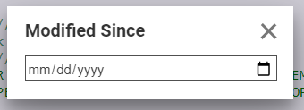

// Build date input text box/style it
const buildDateInput = () => {
dateInputDiv = document.createElement('div');
const dateInput = document.createElement('input');
dateInput.id = 'modified-since-date-input';
dateInput.type = 'date';
dateInput.max = yesterday;
styleMe(dateInputDiv, {paddingLeft: '16px', paddingRight: '16px', maxHeight: '70vh', overflowX: 'hidden', overflowY: 'auto'});
styleMe(dateInput, {width: '222px', marginBottom: '16px', marginTop: '8px'});
dateInputDiv.appendChild(dateInput);

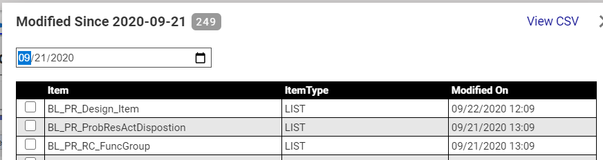

const buildChangesTable = (value) => {
changesListText = '';
const changesTable = document.getElementById('changes-table');
if (changesTable) changesTable.remove();
let changesList = `<div id='changes-table' ${table}><div ${alternateRowBG(-1)}><div ${tableHead}>&nbsp;</div><div ${tableHead}>Item</div><div ${tableHead}>ItemType</div><div ${tableHead}>Modified On</div></div>`;
let sinceDate = value + 'T00:00:00';
let rowCount = 0;
for (let i = 0; i < itemTypes.length; i++) {
const itemType = itemTypes;
const item = this.newItem(itemType, 'get');
item.setAttribute('select', 'id,name,modified_on');
// FIXME: We want unique results. It seems IT properties are heavily versioned.
// groupBy doesn't error, but doesn't appear to do anything
// item.setAttribute('groupBy', 'id');
item.setProperty('modified_on', sinceDate);
item.setPropertyAttribute('modified_on', 'condition', 'gt');
const results = item.apply();
if (results.isError()) {
const errorDetail = results.getErrorDetail();
// No items of type
if (!/No items of type/.test(errorDetail)) {
aras.AlertError('results.isError(): ' + errorDetail);
return;
for (let j = 0; j < results.getItemCount(); j++) {
const id = results.getItemByIndex(j).getProperty('id', '-id missing-');
const name = results.getItemByIndex(j).getProperty('name', '-name missing-');
const modifiedOn = results.getItemByIndex(j).getProperty('modified_on', '-modified_on missing-');
const row = formatRow(itemType, id, name, new Date(modifiedOn).format('MM/dd/yyyy HH:MM'));
changesListText += [id,itemType,name,modifiedOn].join() + '\n';
changesList += `<div ${alternateRowBG(rowCount)}>${row}</div>`;
rowCount++;
changesList += '</div>';
styleMe(dialogDOM, { width: '720px' });
// TODO: Test that this: Why can't we assign this once upon opening and keep the ref?
contentDOM = document.querySelector('.aras-dialog__content');
dateInputDOM = document.querySelector('#modified-since-date-input');
titleDOM = document.querySelector('.aras-dialog__title');
titleDOM.innerText = 'Modified Since ' + value;
titleDOM.insertAdjacentHTML('beforeend', getBadge(rowCount));

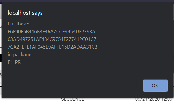

alert(`Put these:\n${checked.join('\n')}\nin package\n${name}\n`);

Anwyway, the above results in a list with checkboxes and an input for package name, and all of that is collected and so badly wants to be a package, but I can't seem to even create the package that I want to add all these things to.
Ideas?
...but, you just get an alert that tells me that I want to make a package with this stuff. I don't get an error when trying to create a PackageDefinition, but it apparently isn't created. Next steps:
  1. Actually create PackageDefinition
  2. Add selections to the new package (using id?)
