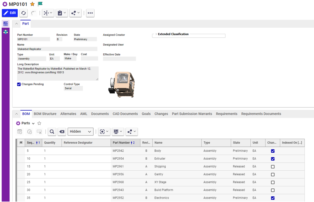

    Below is a screenshot of the default Part form with the BOM relationship below. It's worth noting that the BOM relationship on part only goes one level, while the bom structure tab shows all levels of the BOM.
    If you'd like to change the top part, the Part form, log in as admin and use the Table of Contents (TOC) to go to administration > form> search for Part. If you're looking to modify the grid in the relationship (bottom part of the screenshot), you can modify the BOM itemtype itself. To remove a column from the grid, open up the itemtype and set hidden2 to true on the properties you'd like to hide.

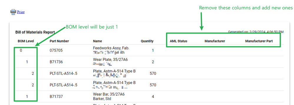

      asebastian  Thanks a ton for replying. I have some more information here.

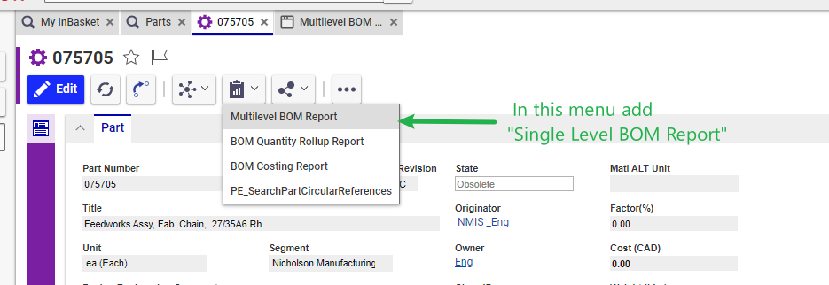

      I need to make a Single Level BOM Report,. So, in the menu where you see "Multilevel BOM Report" there should be a new item "Single Level BOM Report" that goes only 1 level deep.  This report will have some columns that Multilevel BOM Report has and I need some new columns. Also, I need to add the company logo.
      • asebastian's avatar
        So this is a report. You can add more of these pretty easily. Depending on Aras Version you'll either end up using Self Service Reporting (SSRS) or the new Reporting feature released in Release 28. Here is a blog going over using SSRS, and here is the blog for the new reporting.
