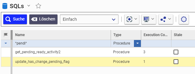

        Have also updated the corresponding "SQL" item ?
