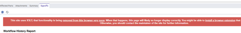

Question: Has anyone of you seen this warning in Edge? The red box appeared wherever XSLT was involved, for example in Signoff tabs and XSLT reports.
One user reported it this week, but since than it´s gone and we never have seen it again:
