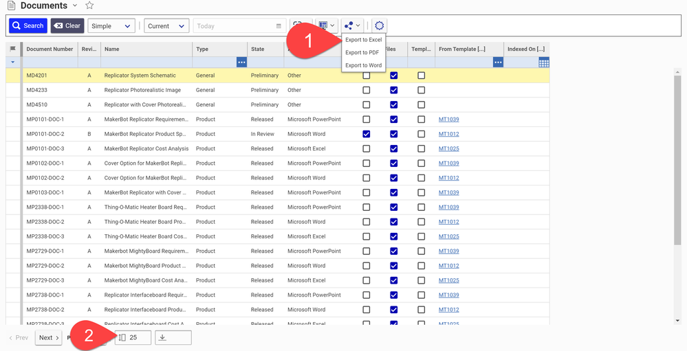

    The first option is the most simple which is to just use the export to Excel functionality that's built-in to all Aras grids. If you're just trying to print out simple metadata, this approach should work for you.
    1. The Export to Excel action that you can use
    2. The max number of entries in the grid. If you want to print all of your documents, you can clear this field and re-run the search.

      Thank you for the quick reply.  I have tried the Query Builder, but have not had any success with it.  It only seems to give me information on the current document I am in.  I'm sure I am missing something.
      I believe that the team that is asking for the report is blanking out the Page Size & then exporting to Excel, but with over 46,000 documents, they have to do it in chunks.
