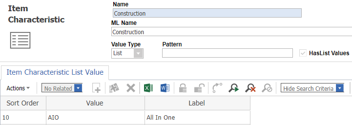

I tried to enter text for new Item Chracteristic 'Construction' as above:
'Sort Order'        'Value'          'Label'
     10                   AIO          All In One

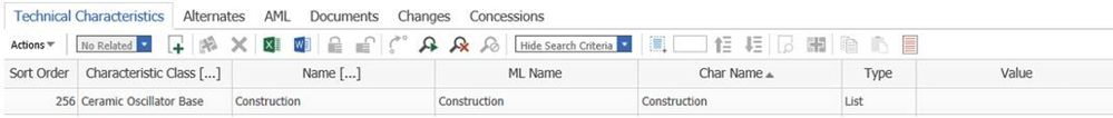

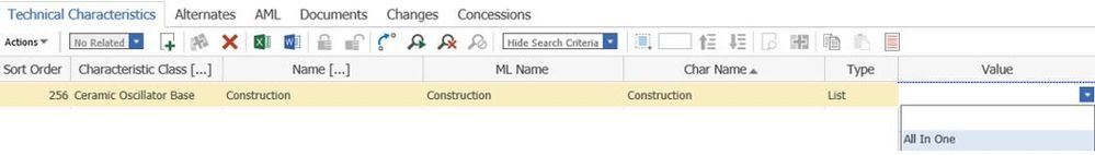

However, once I save it, when I trid to select this new item characteristic of 'Construction' in part screen with All In One' as below,
System save it successfully. But, system doesn't show 'All In One' in 'Value' field, once it refresh screen.
Is it impossible to maintain different text in 'Value' and 'Label' or should I maintain the same text in two fields?
Would you please help on this?
Thank you so much.

  • You can enter Different values in Label and value.
    For your issue, can pls try to save one more time and check it.
  • Hi Nara,
    Thank you so much for your reply.
    As you said, I saved one more time. But, it still doesn't show. (I tried to save more than one time. But, no difference.)
    It's very strange.
