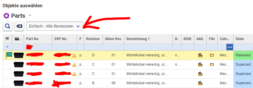

  • Hi Benjamin,
    one simple option that works is using a custom "Search Mode". Basically you copy the "Simple" Search Mode and add the "generation = 0" hack. Note that the "Simple" search mode might be updated in every new Aras version. But most of the time the feature is easy to reproduce.
    This allows you to do something like this (translation of text --> "Simple - All Revisions" ).
    But maybe ask Aras for a better variant if you have a subscription.
