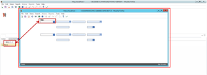

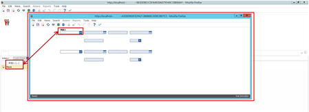

hi,All I set "Open Related Form" on [relationshiptype] so that I can edit the relationship with a popup window when I click "Add Relationship". But I want to bring out the default values in the popup window, I tried the following actions //my code //This is the code I tried to write in JavaScript if ("" === this.getProperty("requ_name","")) { var UserId = this.getInnovator().getUserID(); if (UserId) { //User UserId = UserId.substr(0,32); var User = this.getInnovator().getItemById("User", UserId); if (User.getItemCount()==1) { this.setProperty("requ_name", User.getAttribute("id")); this.setPropertyAttribute("requ_name", "keyed_name", User.getProperty("keyed_name", "")); // The first way ,but it responds with this message { "undefined" : "document.getElementById(...) is null" } document.getElementById("requ_name").value = User.getProperty("keyed_name", "") ; handleItemChange("requ_name", document.getElementById("requ_name").value); // Second way, but it responds with this message { "undefined" : "handleItemChange is not defined" } handleItemChange("requ_name", User.getProperty("keyed_name", "")); //document.thisItem.setProperty("requ_name", User.getProperty("keyed_name", "")); // The third way, but it responds with this message { "undefined" : "document.getElementsByName(...)[1] is undefined" } var vid=document.getElementsByName("requ_name")[1].id; document.getElementById(vid).value = User.getProperty(“ keyed_name”,“”); document.thisItem.setProperty(“ requ_name”,User.getProperty(“ keyed_name”,“”))); } } } Please advise me. Thank you.3.6KViews0likes3CommentsHow to fetch details of nested relationships using AML query?
