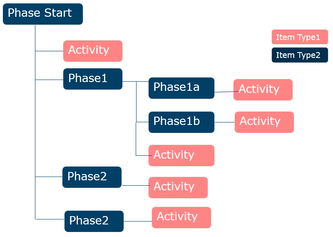

Hi Hyder,
You can check out the first section of this blog post on special aml actions for an example how to perform a recursive AML query which should help you get all of the Activities that you're looking for.

I tried something similar like this. But did not provide any result .(I am using 12Sp3)
<AML>
<Item type="prj_Phase" action="GetItemRepeatConfig" select ="id" >
<id>Test_id</id>
<Relationships>
<Item type="prj_Phase Activity" action="get" select="related_id" >
<related_id>
<Item type="prj_Activity" action="get" select="state,name" ></Item>
</related_id>
</Item>
<Item type="prj_Phase Child_Phase" action="get" select="related_id" >
<related_id>
<Item type="prj_Phase" repeatProp="related_id" repeatTimes="0" action="get" select="id" >
<Relationships></Relationships>
</Item>
</related_id>
</Item>
</Relationships>
</Item>
</AML>- christopher_gillisCommunity Manager
The syntax for this action can be picky. Try using the syntax below instead.
<AML><Item type="prj_Phase" select="id" action="GetItemRepeatConfig" id="YOUR_PART_ID"><Relationships><Item type="prj_Phase Child_Phase" select="related_id" repeatProp="related_id" repeatTimes="0" /><Item type="prj_Phase Activity" action="get" select="related_id(state,name)" /></Relationships></Item></AML>Note that for simplicity, I've also condensed the query for the prj_Phase Activity relationship. You can query for data from an item property by including an additional set of property names in parentheses inside of your select statement. In this example, I'm getting the state and name properties from the item stored in the related_id by using related_id(state,name). This extra bit isn't necessary for the GetItemRepeatConfig action, but minimizing the size of the queries you write can make it easier to work with them.
